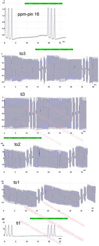

The electronic board has the OKI L9367 integrated circuit; pin 16 is the input signal coming
from the receiver and on this pin you can see the amplified PPM signal. This one is the diagram:
The 27Mhz receiver, demodulator and intermediate frequency filters is very similar to
the diagram shown in the OKI L9362 datasheets:
And the signals are these:
