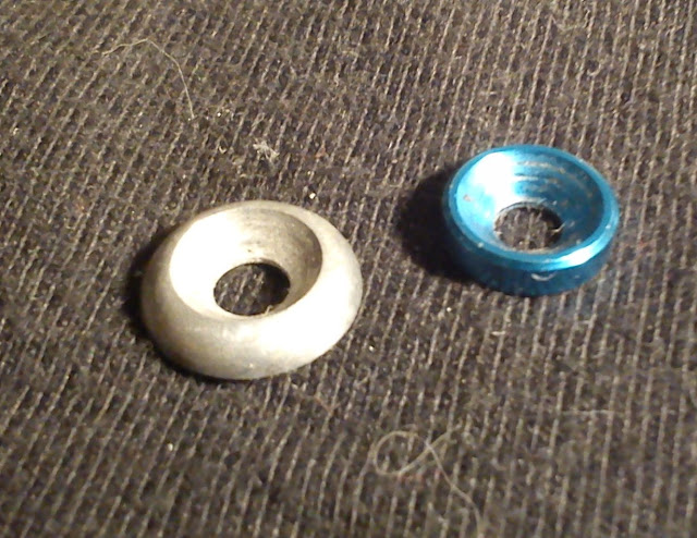

Titanium screws and countersunk washers in the house! :cheer:
Because the T-brand only has blue washers available separately, I had to take off the anodisation...
I tried the "soft" approach first - with bleach. But that didn't do much on these parts so sodium hydroxide was next.
The black smudge tells they are made from an alloy with a high content of materials other than aluminium :
A nitric acid bath cleans up the surface :
The result after etching (on the right below) gives a good insight in the molecular grains. Almost looks like granite!
On the left a washer after a first polish with the Dremel and some special paste.
Needless to say there was more work to do...
Ending up in probably the job with the highest ratio of labour to part size I've ever done.
Nothing compared to finding a Higgs particle though.
:silly:
A definite improvement on fitting the undercowl :
